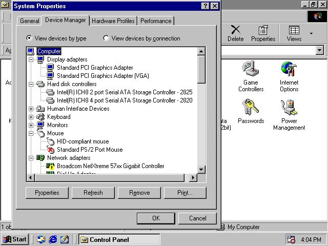

Well, it turns out that I have SATA drivers that are compatible with my machine that work in Windows 98:
For the record, no matter what I did with UIDE.sys, UDVD.sys and UHDD.sys. I always ended up with some flaky behavior. I'm not saying that it's necessarily and issue with UIDE, it may be some combination of using FAT 32, Windows 98 SE, HimemX, the way HimemX has to be configured -- who knows. The /B switch come the closest to working of anything I could find, but eventually I'd get registry writing errors and have to reboot every few boots of Win98 SE. With any /S switch I tried defining a cache size, I'd get file writing errors that would show during the installation of 98 SE -- OBDC version errors, errors accessing certain files, et cetra. Windows would eventually boot, but explorer wouldn't load. I did test using UIDE with /B to install an old 98 SE upgrade CD, using an old Win 95 CD to pass the validation check and it worked for that, but I removed UIDE after the first reboot.
Also found Xrayer's old update for io.sys (w98iopat.exe) at TmEE's site, it fixes not being able to get in Safe Mode when using himemX. I've also started using his settings recommended for himemX, MaxPhysPage, MaxFileCache, MinFileCache and ChunkSize in the patch.
Windows 98 SE is now installed. It boots with SATA operation set to "Normal" in the BIOS. I don't have access to the DVD drive, but am dual booting so I can deal with it. I have other issues to deal with on it and I have a partition with Windows 2000 Pro (I'm using it now).

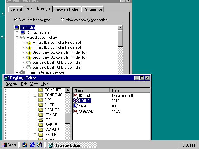

I was going to put this off to the weekend because I thought I'd have to reinstall to test, however I had another idea. I added uide.sys back in to the config.sys and mscdex back in the autoexec.bat. I booted in to Safe Mode, removed the SATA controllers and added NOIDE to the registry, when I rebooted when wanted to reinstall the controller, but gave me the options to install the controller that Windows originally installed. Given that I already know how to install this way, this will allow me to test UIDE (with the /B switch) and NOIDE in the registry. So far, so good. I'll keep using it this way for a few days and see how it goes.
autoexec.bat:
LH C:DOSDRVmscdex /D:DVDRW /L:D
config.sys:
device=C:WINDOWShimem.exe /MAX=1048576 /NUMHANDLES=64 /VERBOSE
devicehigh c:DOSDRVuide.sys /B /D:DVDRW
Note: himemx.exe has to be renamed himem.exe and put in the Windows folder so that Xrayer's patch I mentioned earlier works and you can boot in to Safe Mode.
HKEY_LOCAL_MACHINESYSTEMCURRENT CONTROLSETSERVICEVXDIOS
There make your "String value key" NIODE=01
I copied the Win98 Folder from my install CD to My Documents to test. I got the system sluggishness that I was expecting. From previous experience with the NOIDE setting, it is really only noticeable when large files get moved, for example you copy files, or when a download gets moved from a temp/cache folder to where you told a browser to save it.

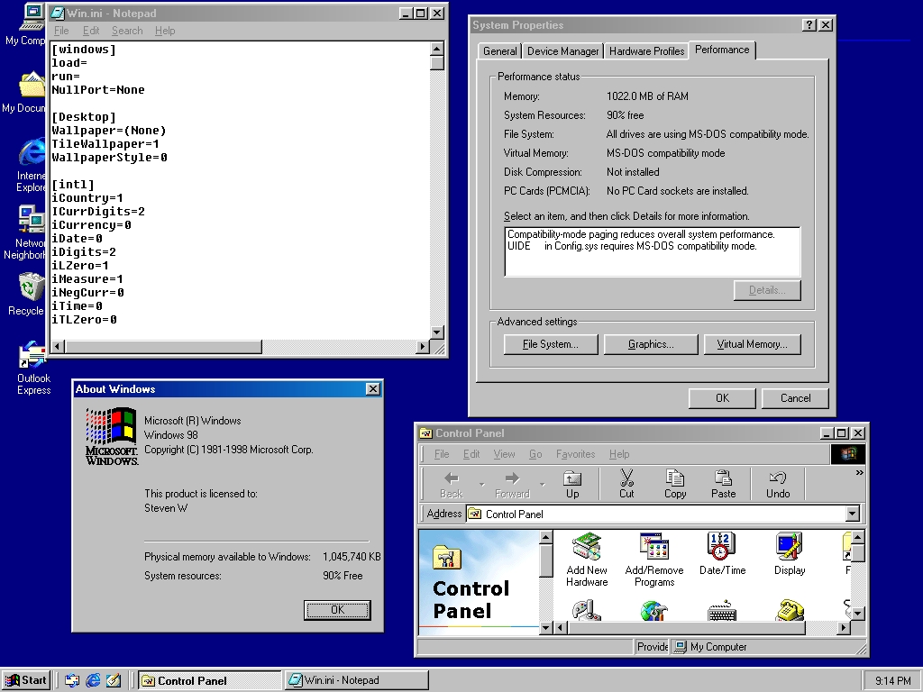

Here you go, "!":
I installed VBEMP 9x
http://www.bearwindows.boot-land.net/vbe9x.htm
Changed the wallpaper and was running a few programs. I've made several changes to the OS and rebooted several times. Preliminary guess is that UIDE is good with the /B switch and NOIDE in the registry.

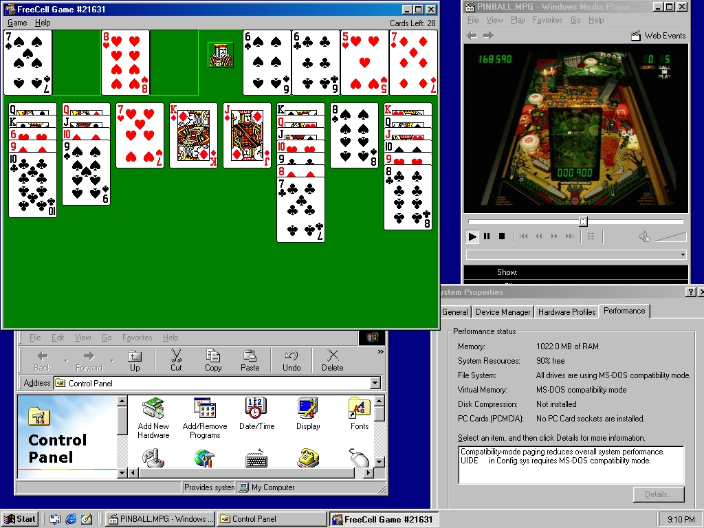

I'm calling the UIDE experiment a success. Windows 98 Second Edition operated just fine other than the file copy/moving big/lots of file(s) sluggishness issue.
I had a little thought in my head and I just tested it out. The thought was that maybe there's something about the installation that requires UIDE's /B switch and maybe I can use it's caching in the OS once it's fully booted. That was a *no-go*. I replaced the /B switch with /S255. When I rebooted several shortcuts on the desktop suddenly showed their dos file names and instead of their Windows icons, showed a generic executable icon. I also received a message about one of my drivers no longer working, might have been due to the caching using the same memory area as the driver was assigned -- I didn't bother to investigate. I figured given the other issue; why bother?
In short, if UIDE works for your hard drive/ CD/DVD Rom/RW in DOS, it most likely can work with WIN 9x if you use the /B switch. I have my doubts that any Windows disc burning software would work, but if you're multi-booting like I am, who cares?
