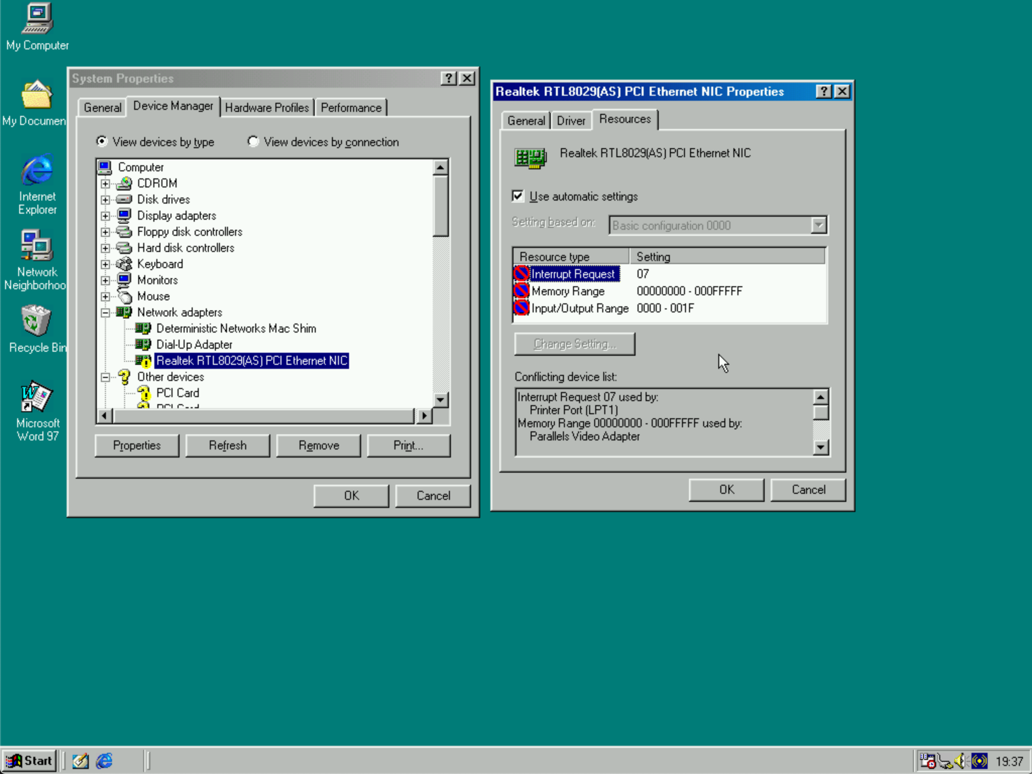

I note there's and exclamation point on the network card in the device manager, you should be able to get some info as to the problem... Is the driver correct? Is it disabled? IRQ conflict...

I've made a small progress, there was really a IRQ conflict.
Screenshot 2020-04-26 at 19.37.24.png (325.63 KiB) Viewed 66950 times

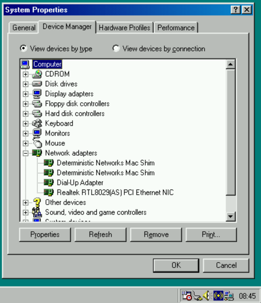

I had to remove the printer port, go on the network car troubleshooter and then it worked!
The drivers are the ones from the beginning, from Parallels Tools.
It is a bit annoying now that every time I restart the printer port is back and I have to remove and troubleshoot everything again. But works!
Screenshot 2020-04-27 at 08.45.37.png (127.75 KiB) Viewed 66950 times
Now must be up to configuring the right addresses! I will follow your last posts later today and give an update!

In the end I can't access Mac folders, I've tried everything. The Windows 10 uses a program that is part of Parallels Tools, called Shared Folders. But this doesn't exit for the Win98 and there seems to be no way to see the Mac from inside Win98.
In the moment I have everything working: video, sound, network card (the LPT1 port stopped appearing, I think it gave up), and even the internet is working in the Win98!
Thanks a lot for all help, Steven! Wouldn't have made without you! :clap:
I tried to do what you've said, I still have a few unidentified hardwire but was not able to install anything more using those drivers.
Anyway, it works!
