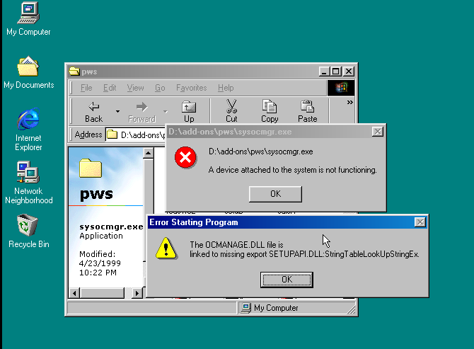

I had been testing USP3.53 for a while. I stumbled on a bug that may be interesting to some users.
When I try to install PWS from the Windows 98 SE CD-ROM (D:add-onspwssetup.exe) the following message appears:
"Unable to run D:add-onspwssysocmgr.exe"
When I try to execute D:add-onspwssysocmgr.exe the following message appears:
http://s7.postimg.org/w17pu5bh7/usp3bug.png
Have tested it after installing Main updates only on a fresh Windows 98 SE installation.

sysocmgr.exe is an Windows NT. file and cannot been run on Win98. Sorry
This specific sysocmgr.exe is part of PWS 4.0 (Personal Web Server), and should run in Windows 98 SE (I have tested it on clean install).
It's not a serious issue anyway, just some API calls from the ocmanage.dll seem to be missing.
Anyway, who uses PWS 4.0 nowadays? ;)
