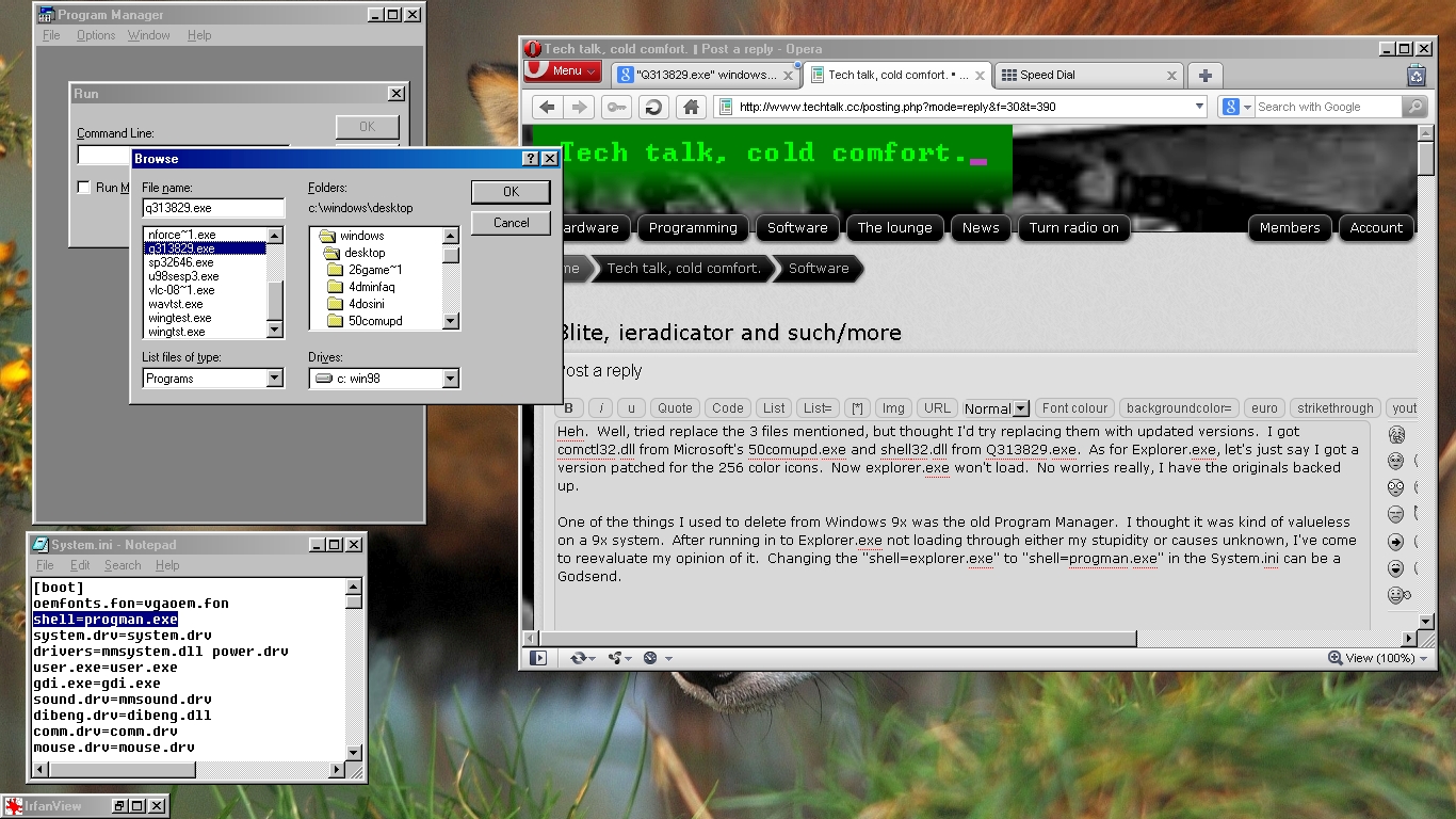

Heh. Well, tried replace the 3 files mentioned, but thought I'd try replacing them with updated versions. I got comctl32.dll from Microsoft's 50comupd.exe and shell32.dll from Q313829.exe. As for Explorer.exe, let's just say I got a version patched for the 256 color icons. Now explorer.exe won't load. No worries really, I have the originals backed up.
One of the things I used to delete from Windows 9x was the old Program Manager. I thought it was kind of valueless on a 9x system. After running in to Explorer.exe not loading through either my stupidity or causes unknown, I've come to reevaluate my opinion of it. Changing the "shell=explorer.exe" to "shell=progman.exe" in the System.ini can be a Godsend.
Such is life. I will keep on tryin'.

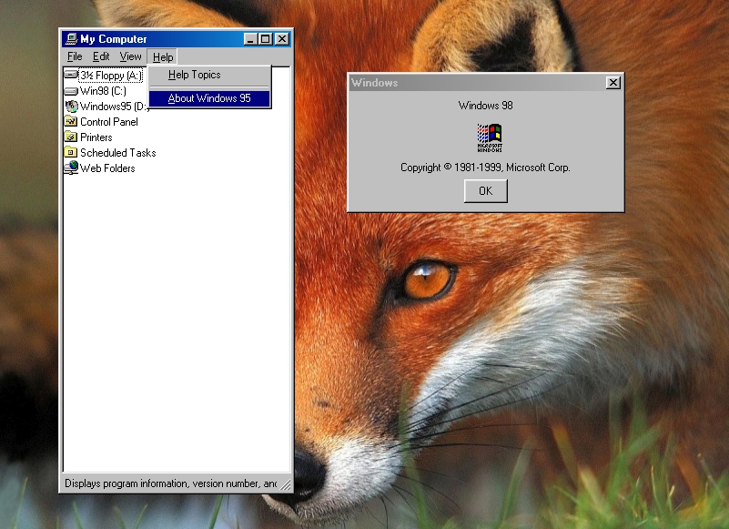

Keep in mind that I installed 98 SE, applied most of the Unofficial Service Pack and am now trying to remove IE and go back to the 95 shell. I copied the files from the 95 CD and had to extract and copy another -- comdlg32.dll. It's now bootable and doesn't give error messages, but a lot doesn't work. Right off the top of my head, some programs refuse to run, much of the Control Panel stuff doesn't work and when I right-click on an empty spot on the desktop and choose Properties, nothing happens (that's really a Control Panel extension). Anyhow, I'll try to keep posting here as I work through this. Had to use Firefox 2.x, as Opera wouldn't load. :smile:
Here's a fun screenshot:
Okay, back to workin' it! :wave:

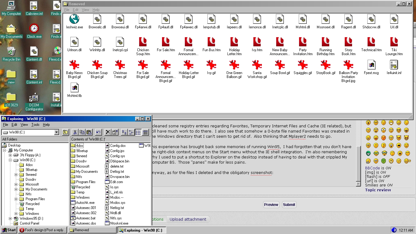

I got w95powertoy.exe and installed it's cabview files, because I lost the ability to open CAB files as folders. Also reinstalled tweakui, because that was non-functional. During installation of each, if the computer reported a newer file was on the drive I kept it. In addition to all the files mentioned before, I copied notepad.exe, write.exe and wordpad.exe to the hard drive. Knew those would be problems from the CNN link show previously. I got Opera to work I ran it's setup and chose the remove option, delete its folder in Program Files and its profile folder (forget where that was at the moment). I reinstalled and it wouldn't open giving an error regarding profiles, but in its main folder there's a file, operaprefs_default.ini, and if you edit the line 'Multi User=1' to 'Multi User=0' it runs again. Anyone using 9x as a multi-user system, unless not at all concerned with privacy with those their sharing it with, is a damned fool.
I've also cleaned up a bunch of stuff, some files, some folders. Found folders with a server relating to IE somehow and old stationary for Outlook Express among other things. One thing I found a bit odd was the fact that if you delete a folder, you don't see it in the recycle bin, instead you see the files that were in the folder. Did Win95 do that by default?
I cleaned some registry entries regarding Favorites, Temporary Internet Files and Cache (IE related), but still have much work to do there. I also see that somehow a 0-byte file named Favorites was created in the Windows directory that I can't seem to get rid of. Also thinking that Mplayer2 needs to go.
This experience has brought back some memories of running Win95, I had forgotten that you don't have the right-click context menus on the Start menu without the IE shell integration. I'm also remembering why I used to put a shortcut to Explorer on the desktop instead of having to deal with that crippled My Computer BS. Those "panes" make for less pains.
Anyway, as for the files I deleted and the obligatory screenshot:
Don't mind the mess on the desktop, that'll get cleaned eventually.
