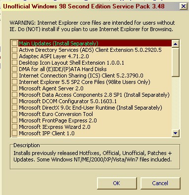

I used a backup to restore my system after reading the help file and bogging down with
that very lengthy options list (see attached jpeg).

Problem Two:
I consider myself an advanced computer user, but that options list was overwelming.
The warning at the top about IE core files is not logical. IE_v6.0 is completely dead
on the internet. 6.0 was the last version compatible with 98SE. When I connect to
the web with 98SE I use a third party browser like SeaMonkey, Opera, etc.
I didn't count the number of items on the options list, but it's a lot! Maybe 75% of the
items are easy to select or deselect. I need to be 100% confident about all the items
on the options list before installing a USP. Is there a detailed explanation for each item
on the list?

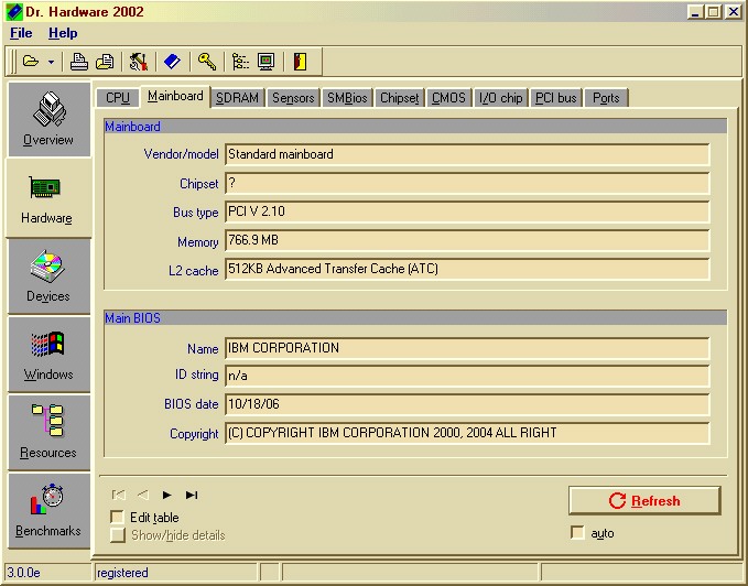

Yes, you are correct about the USB instructions. What is the make of the motherboard/chipset?

I've got an IBM ThinkPad that was designed for XP. That's where my copy of 98SE is
installed. You can see the attached jpeg from an app called Dr. Hardware. Unfortunately,
when I selected the chipset tab there was no info. A dialog box appeared asking if I wanted
to see the help file.
