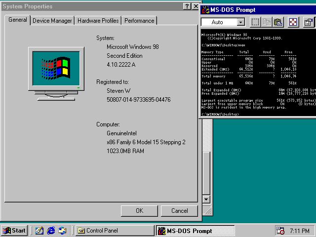

Okay, very soon I'm going to mess about with getting several Operating Systems going on this PC. One of them is going to be 98 Second Edition. I'd like to hear from those of you who've used 98lite and/or IEradicator. I know one of the "consequences" for this would be the elimination of the back and forward buttons in plain old Windows Explorer. Are there other consequences? Does some software "require" IE? If I use the "core files" from the 98 SE USP, how much of IE will actually be there? I figure the positives (especially security related) would outweigh the negatives -- any thoughts on this would be appreciated.
Those of you who know me from MSFN, know that I'm not completely clueless about installing this old OS on more modern hardware. There is that thread about installing 98 SE on my Intel 945. Even though I'd have figured out the issue was with the hard drive eventually, I am grateful to dencorso for speeding that up dramatically. Well, this one should be even more fun (headache inducing) its more modern and has more RAM. I'm not going to put up the details just yet, as I want to attempt it entirely on my own. I'll eventually get the details out, if I get it going or run into problems I can't resolve. I will say this though, I do not plan on buying any patches or drivers. If I can't accomplish this with freely available software, it ain't gonna happen. Paying for such things just to run an ancient OS is, in my eyes, foolish.

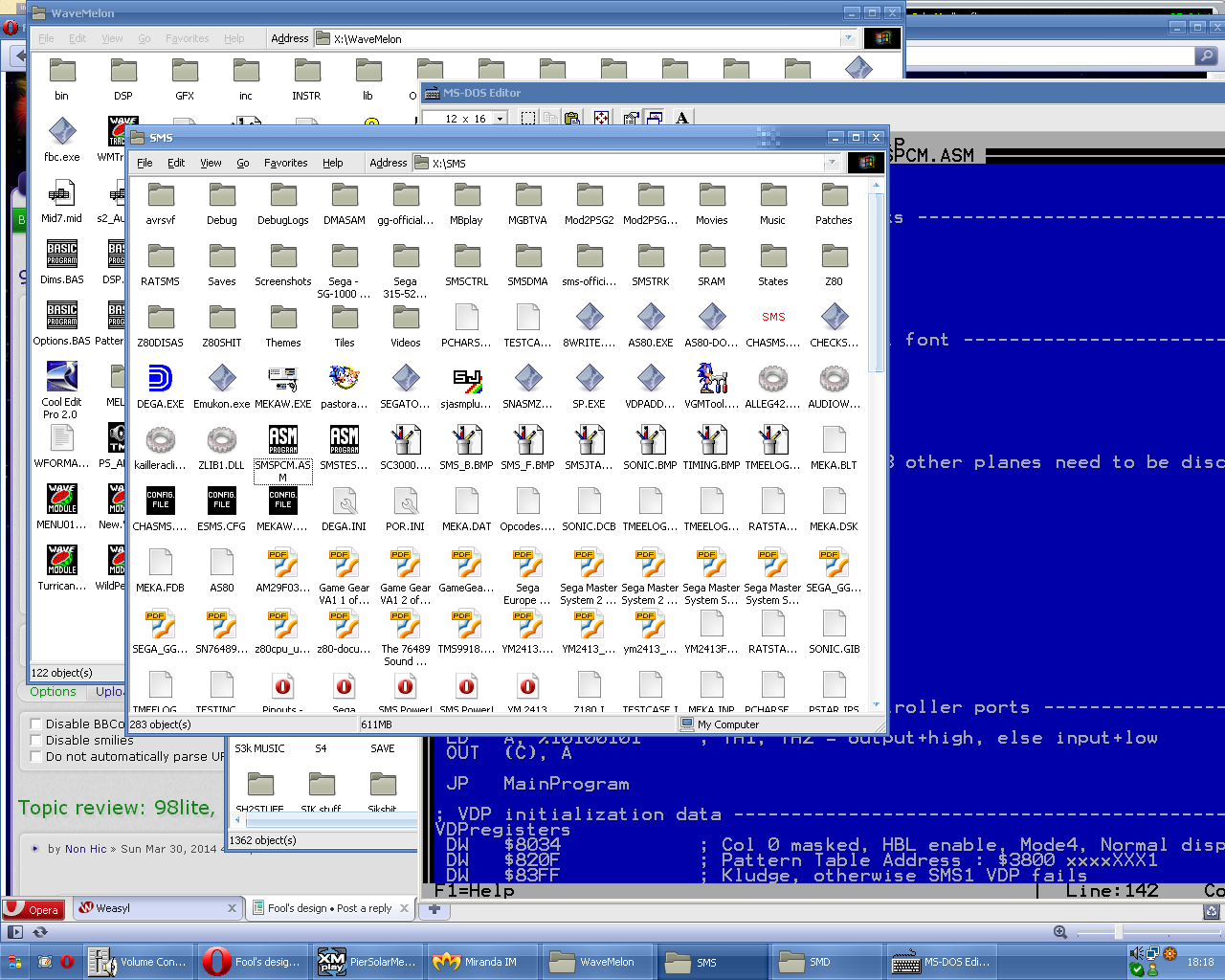

Now, I'm going to go a bit off-topic. I can do this because ***IT"S FOOLSDESIGN!***. I've used XPlite to remove Windows Media Player from XP before. When I did, I ended up with an odd issue. When adjusting the volume using Window's Volume control, releasing the mouse would result in the PC speaker beeping loudly. Any thoughts on that issue? I'm debating removing Windows Media Player from 98SE, but I do like Windows Media encoder for doing things like screen captures et cetra. Here's an example of something I did with Windows Media Encoder (although on XP) that I think it does a really good job at:
I was demonstrating an issue with LibreOffice's toolbars (since been resolved). Windows Media Encoder is nice in that it allows me to configure it to capture a selected area of the screen and the codec, while not my favorite and a bit old, still compresses enough to result in a small file size. Do you guys know of any other software compatible with Windows 98 that meets those two criteria? A fairly common codec H264, VP8, etc, would be nice. Being able to convert other files (AVIs, et cetra) to a different format would be a bonus, although not necessary. If you know of one that 2000/XP compatible only, sing out too. I'll be looking for that in the not-to-distant future.

The media player can stay in windows 98. Its WMP7+ that are the ones that one really doesn't need there. 6 is still present all the way up to WinXP. Just type mplayer2 in run and off you go, no need to have the bigass memory hog go on about when you want to hear something
Removal of IE has always caused me endless headache, I would just leave it be. There will likely be no feelable speed difference in operation but boot will be just a bit faster without IE... but how often do you reboot ? Once a day maybe.
Lack of back/forward doesn't bother me, I remove the buttons to make more room for things that matter and have all folders open in their own windows :

Okay guys, the system is a Dell Optiplex 745 Desktop (Desktop is the form factor). It has a 1.86 GHz dual core Intel processor. It now has 160 GB Hard drive and 3 GB RAM. I yanked memory and hard drive out of my old Emachines W3629 (Intel 945) and am disposing of it. I was about to post in the Hardware forum and ask if anyone had installed a second hard drive in one of these, when I looked at the case and realized the extra slot is intended for a 3.5" diskette drive. I rather imagine with a little metal work, one could turn that to an extra hard drive slot. Oh well, have an extra 80 GB hard drive now. Running a Linux Distro's Live CD for the time being, getting tired and don't wanna fuck with it.

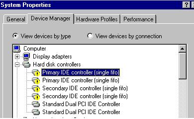

Woot! I got it booting in "Normal" SATA mode. There may be some slowness with file copies / moves / transfers. I'm not sure yet, as I need to attempt to update drivers. If there are issues, I suspect they'll be minor and at least I won't have to be in "Legacy" mode in other operating systems or have to switch the setting in the BIOS every time I want to run 98 SE.
I copied the 98 SE installation to the hard drive (not certain this is necessary). I had this config.sys until the installation asked to reboot:
note the /B switch for uide.sys, that is what I think the trick is. It's either that or copying the installation to the hard drive. My guess is that Windows / Windows installation doesn't like uide.sys's caching.
When the installation asked to reboot, I put the Emergency Boot CD in the drive and rebooted. Started without CD-ROM support and modded config.sys:
