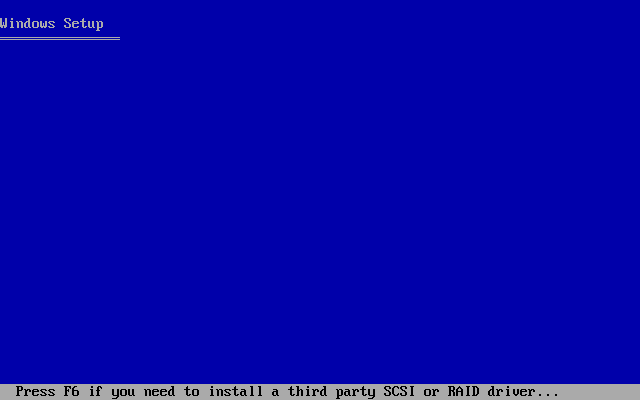

Let me touch on a few obvious and a couple of not so obvious things:
I've seen stupid crap like a dead CMOS battery cause problems with ACPI, essentially you losing settings. I've heard memory issues can cause problems. I'm assuming this is XP 32-bit and you have 4GB or less or RAM. Easy way to make sure it isn't the battery, is check date/time in BIOS reboot and make sure it's keeping time, more thorough approach, unplug PC for a couple of hours and make sure it's keeping time. I'd pop the hood and makes sure the RAM is seated well, perhaps even reset it. Make sure it all reported in BIOS (turn on Memory Check during boot if it's available).
Now the not so obvious:
If all else fails, sensibly disable power options in the BIOS (if you can), possibly put any SATA controllers in Legacy Mode (again, if you can) and when installing XP and you get to this screen:
Press F7 (yes, I said F7)
https://support.microsoft.com/en-us/hel ... ction-keys
and choose the Standard PC option.
Despite what many say you can change your ACPI options later:
https://zedt.eu/tech/windows/switch-win ... reinstall/
http://praetas.blogspot.com/2012/08/del ... p-can.html
You can download proper storage drivers (often just included in chipset files from Intel) extract the somewhere (make it easy to point to and remember where), boot to Safe Mode remove drivers for (sometimes just delete devices altogether) for the device manager, reboot change setting from Legacy to SATA and when Windows asks for drivers point to the folder where you extracted files.
It's obviously difficult to diagnose problems without being there, but hopefully all this helps. Good luck!

2019-04-26 06:49 »
2019-04-26 06:20
I've already tried using f5 and f7 options without success. The computer is a Dell Inspiron 20 3034 All-in-One with a Bay Lake-M CPU.
Despite finding a ACPI.sys fix on MSFN, can't just simply replace the ACPI.sys located in i386 because the driver is located in a LZX:21 archived called "ACPI.SY_".
I tried manually replacing the file with a compressed folder and changed the name and extension, but no luck: Windows XP setup says the file is corrupt then...
https://msfn.org/board/topic/178362-ins ... BB%BF-cpu/
https://msfn.org/board/topic/178368-mod ... zx-format/
JiaoTongNan
2019-04-26 06:50 »
Also, I used this custom SATA driver. It got me past the SATA error but now the ACPI error is present. When I use the f5 and f7 options, I only get another error..
