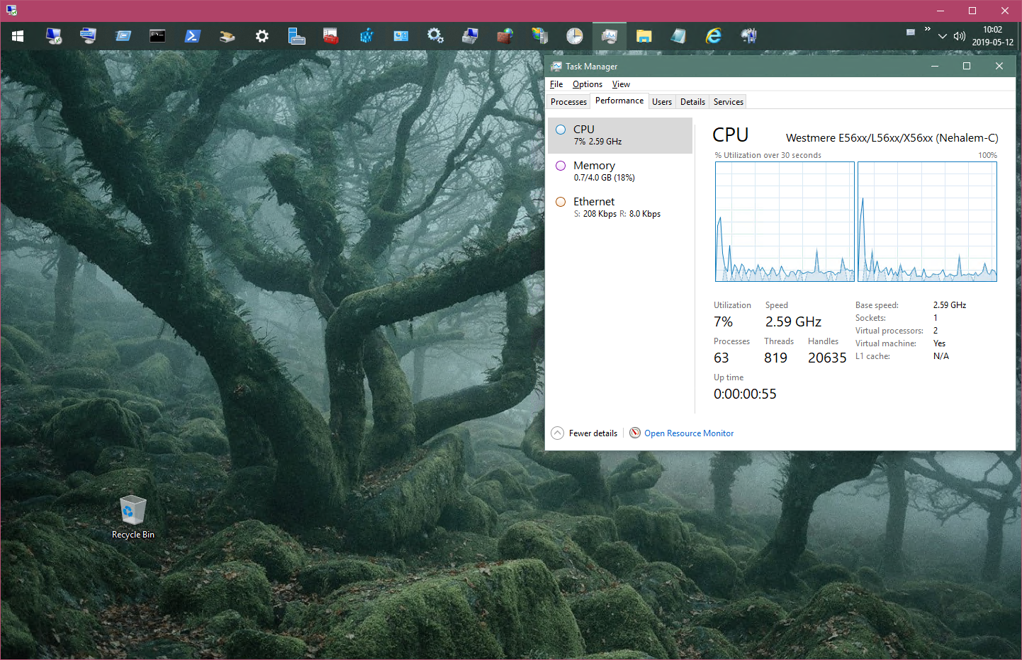

Windows Server 2019 light / lite edition.
(I have some more settings for Group Policy (GPO) to make Windows safer and nicer and more private. Yes, I turned off Windows Defender and smartscreen as well. I'm not fully done with them yet but I will post them here as soon as I'm finished with them.)
I have found that turning off these services is totally safe and Windows Server 2019 will continue to operation without any issues. This is my own version of "light / lite edition". Please bear in mind that before doing all this, update Windows fully and install IIS or whatever else you need to install on the server. Run Windows update again to be on the safe side, reboot and then turn off the junk.

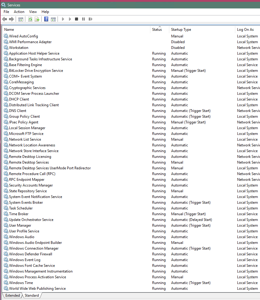

Turning junk services off:
The ones which I marked "registry" can't be turned off from the command line. You can put the script into a .bat file but remember that the ones who have "registry" in the "REM" line, will give you "Access is denied.". You must go into registry (regedit) and find them under "Computer\HKEY_LOCAL_MACHINE\SYSTEM\CurrentControlSet\Services". Edit "Start" value and set to "4" to make them "Disabled".
Windows Server 2019 light - lite edition.png (2.15 MiB) Viewed 78452 times
running windows services.png (110.56 KiB) Viewed 78451 times
