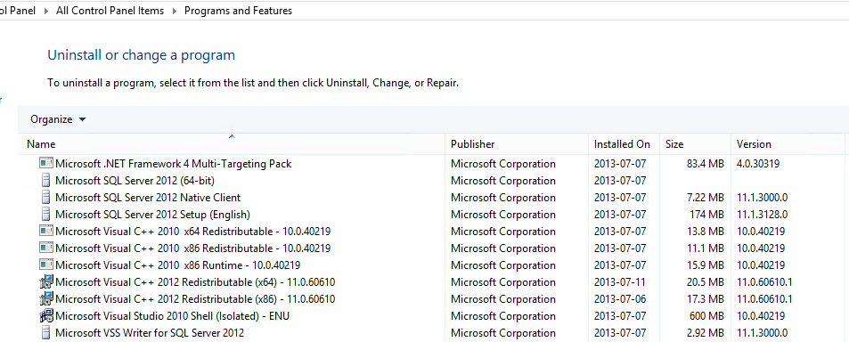

You must install x86 Visual C++ Redistributable for Visual Studio 2012. (Otherwise, you will get odd security errors)

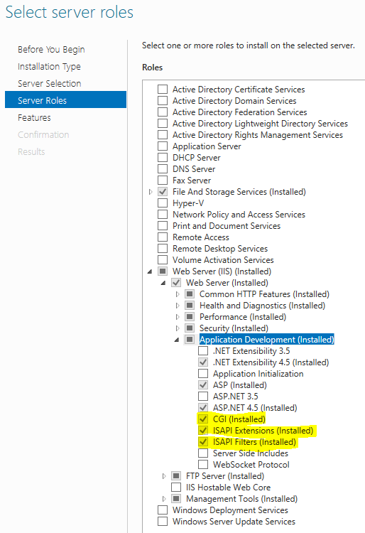

To get PHP working in IIS 8.x, you need to install CGI and ISAPI stuff:

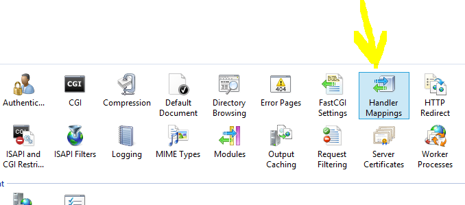

From your Internet Information Services (IIS) Manager, you find this icon:

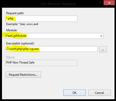

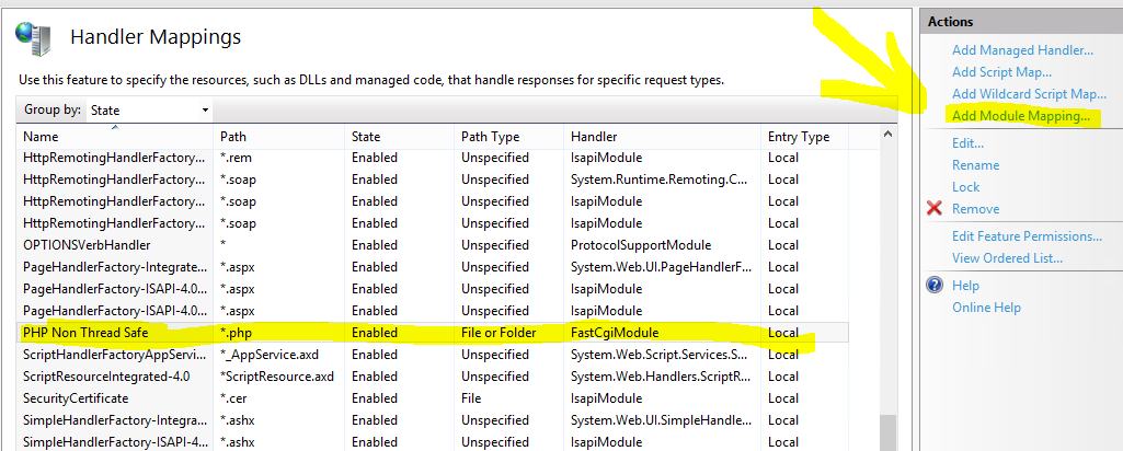

Inside that icon, you click on "Add Module Mapping..." and add .php as an extension:
Like this:

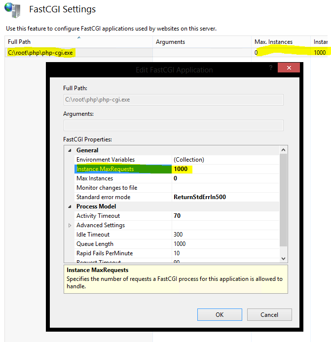

There is also this icon "FastCGI Settings" where you can alter some settings, for example "Instance MaxRequests" etc.:

I use MS SQL Express 2012. You must have the SQL 2012 Native Client installed. As you can see, I have removed a lot of "crap" from our SQL installation. :lol:

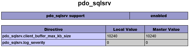

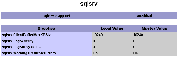

To see if the drivers actually loaded by your PHP, try running this code:
<? echo phpinfo(); ?>
If you do not see the following two sections, it means PHP has NOT loaded your drivers!
Remember: You must restart IIS for it to load the drivers after you added the lines for them in your php.ini file.

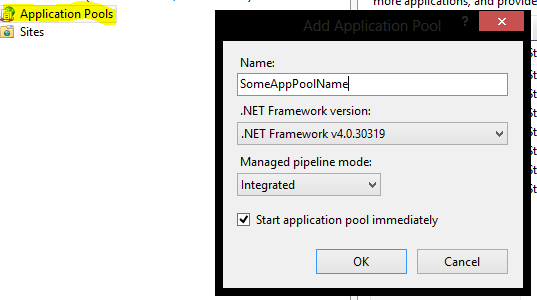

Then you must create a new application pool in IIS (From IIS Manager) and allow your site to run with that application pool.

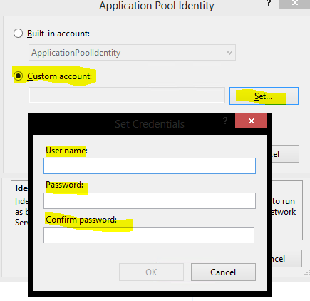

You need to set an identity to your application pool. This "identity" is the Windows user account that you created from the "Computer management". Upon creation of your Windows user account, you also set a password to it. You will need that password when you add the user to your application pool in IIS.

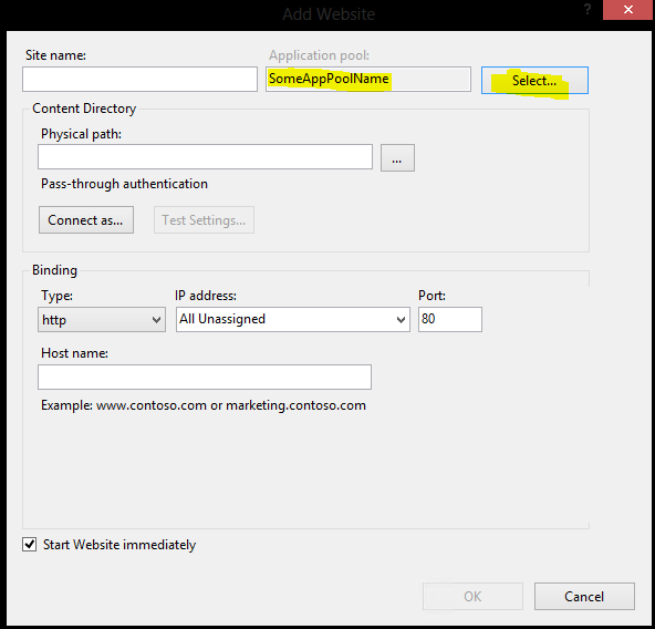

Now you can create your new site and choose so it uses the application pool which you created earlier:

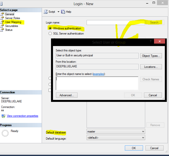

Of course, you must add the Windows account which you created as an SQL login and allow it to have access to the chosen database. From the "SQL Server Management Studio" where you manage your databases (you get the Management Studio from the MS SQL Express install, from their Web site you can choose to download it), you go to "Security", "Logins", "New login". There you add your Windows account user, choose some "User mapping" to give it access to databases and also set a "Default database" for the user.
