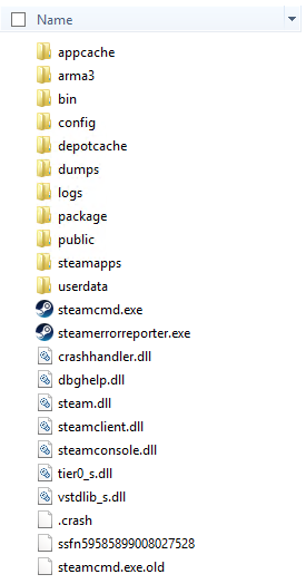

It will take a while and ARMA 3 dedicated server will install in the same folder as you are running "SteamCMD" from.
You will get something like this:

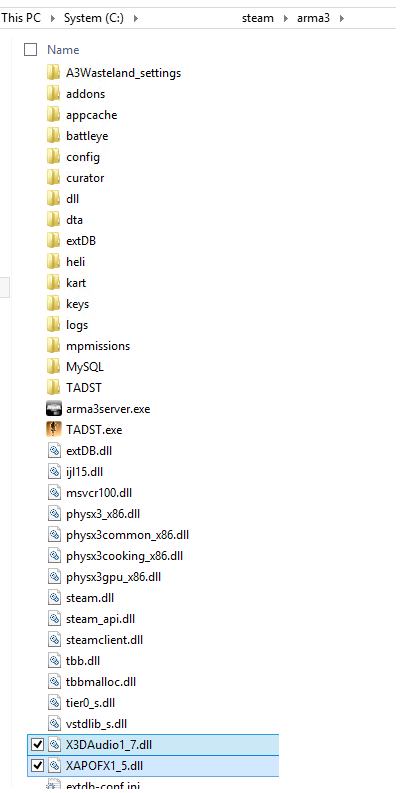

If you run the ARMA 3 now, you will get missing DLLs error. In order to get ARMA 3 running on a server, you will need these two DLL files. I you don't trust these files which I found from my Windows 8.x installation. Just do a search and you can find them in your system drive somewhere. They should be safe, however.
XAPOFX1_5 X3DAudio1_7.zip
(46.97 KiB) Downloaded 1957 times

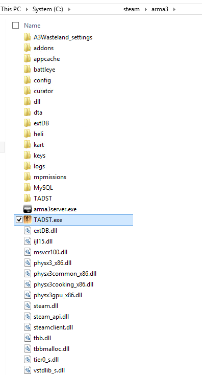

Put the two DLL files into the same folder as your "arma3server.exe", which in this case is "steamarma3" for me.
two dlls.png (37.09 KiB) Viewed 53545 times

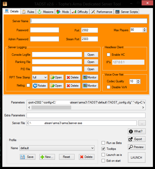

The next tool you will need is "Tophe's Arma Dedicated Server Tool (TADST)" which you can download here: http://www.armaholic.com/page.php?id=11655. I will attach the version I currently use in here but please download it from the original source in case a new version is there. I will NOT keep this file up to date and/or mirror in here.
TADSTv2.6.zip
(86.62 KiB) Downloaded 1747 times
Put the TADST.exe in the same folder as "arma3server.exe":

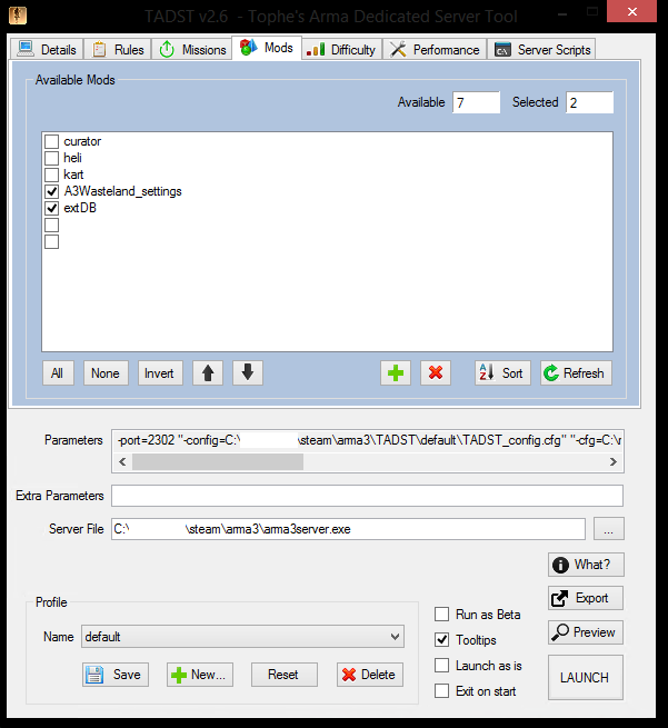

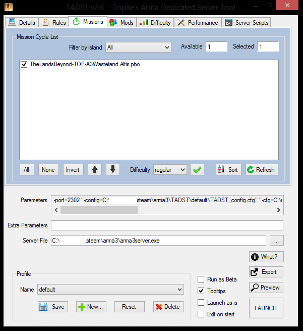

The easiest way to launch the arma3server.exe with the correct configuration is using TADST. You just choose which mod (.PBO) you want and add-ons in the program and launch it. Something like this:
TADST 01.png (40.1 KiB) Viewed 53539 times
TADST 02.png (33.01 KiB) Viewed 53539 times
TADST 03.png (32.1 KiB) Viewed 53539 times

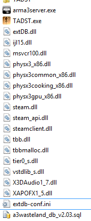

They gave me a .SQL file called "a3wasteland_db_v2.03.sql". You load Workbench and run that file. It will create your database for you. After that, you add a new user to MySQL and add that user + password + server IP to the "extdb-conf.ini" file.
extDB files.PNG (12.13 KiB) Viewed 53539 times
The folder "A3Wasteland_settings" goes into same folder as "arma3server.exe" and the .PBO mission file goes into the "mpmissions" folder.

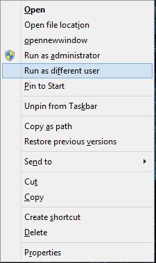

By the way, if you don't like to run the TADST or ARMA3 server as an administrator, to be more secure, you can just create a new "regular" user and run the programs with the "Run as..." command. You hold down SHIFT+CLICK on the program to get the "Run as..." menu.
I usually do this because well, I don't trust a game server to run as an administrator on my servers. :mrgreen:

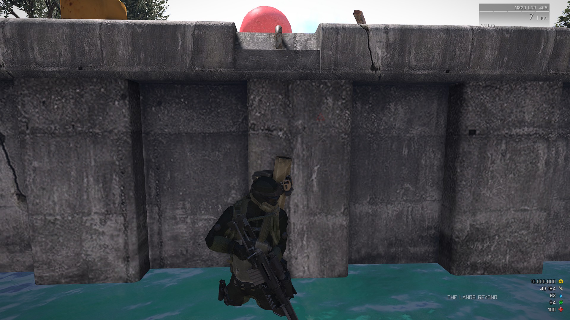

Finally when I load the mission of wasteland my friends and myself spawn in water many miles from the earth.

I wonder, maybe your extDB can't connect to the MySQL server? That could be why you all spawn in water. Just a guess, however. If you want, I could also login to your server by Remote Desktop (RDP) and check what can be wrong.
