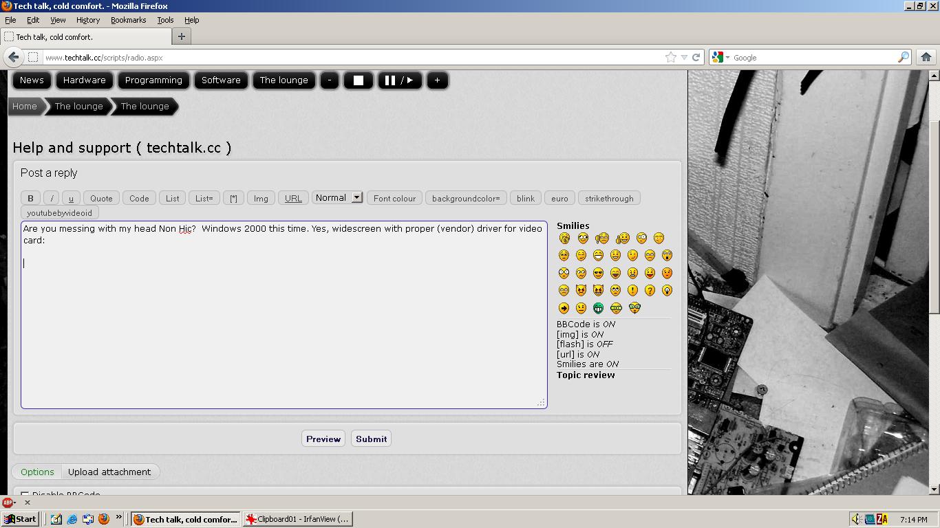

Are you messing with my head "!"? Windows 2000 this time. Yes, widescreen with proper (vendor) driver for video card:
Seems like it changed in the middle of this session!

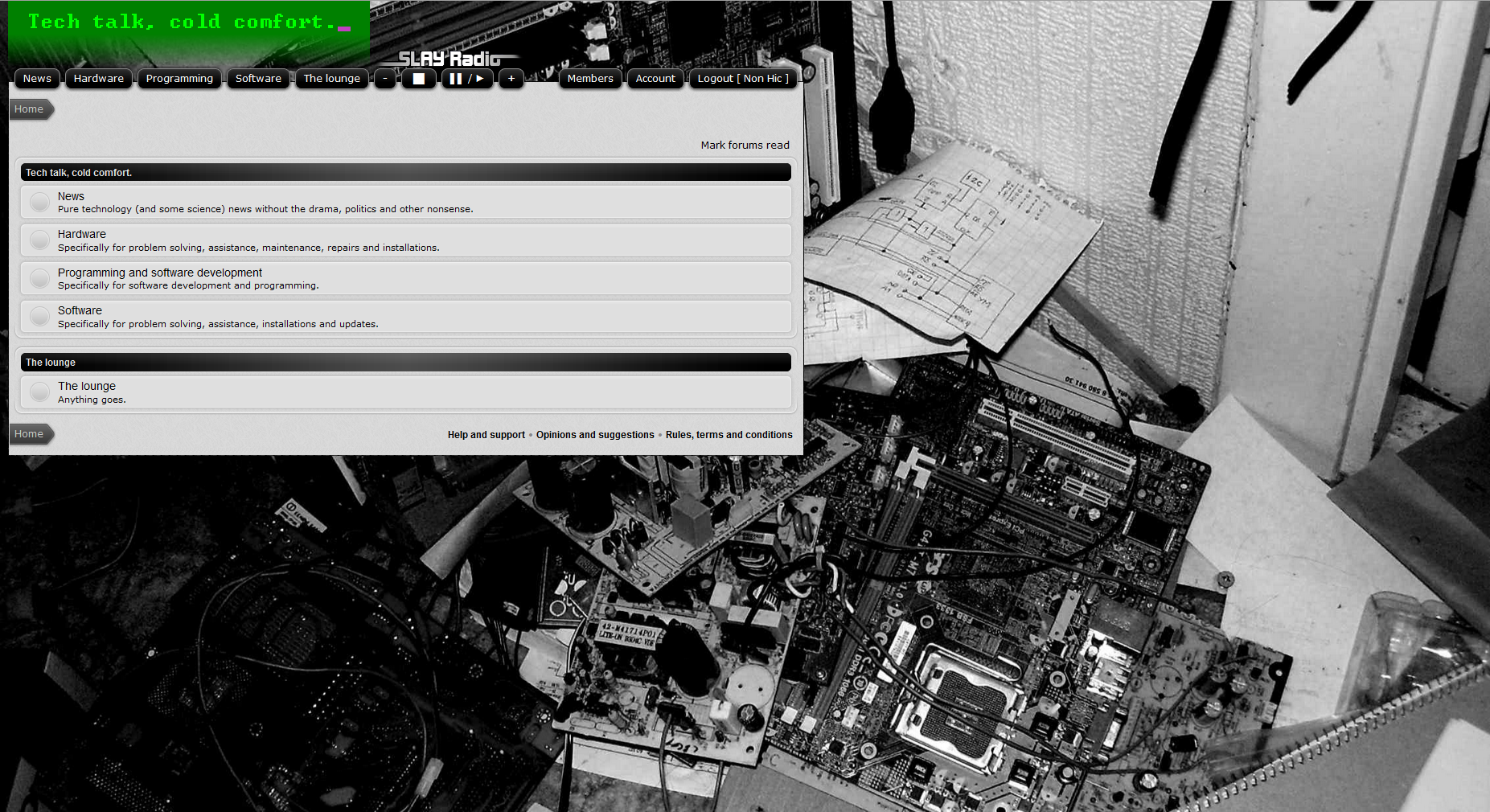

2014-05-23 01:50 »
This is what I see:

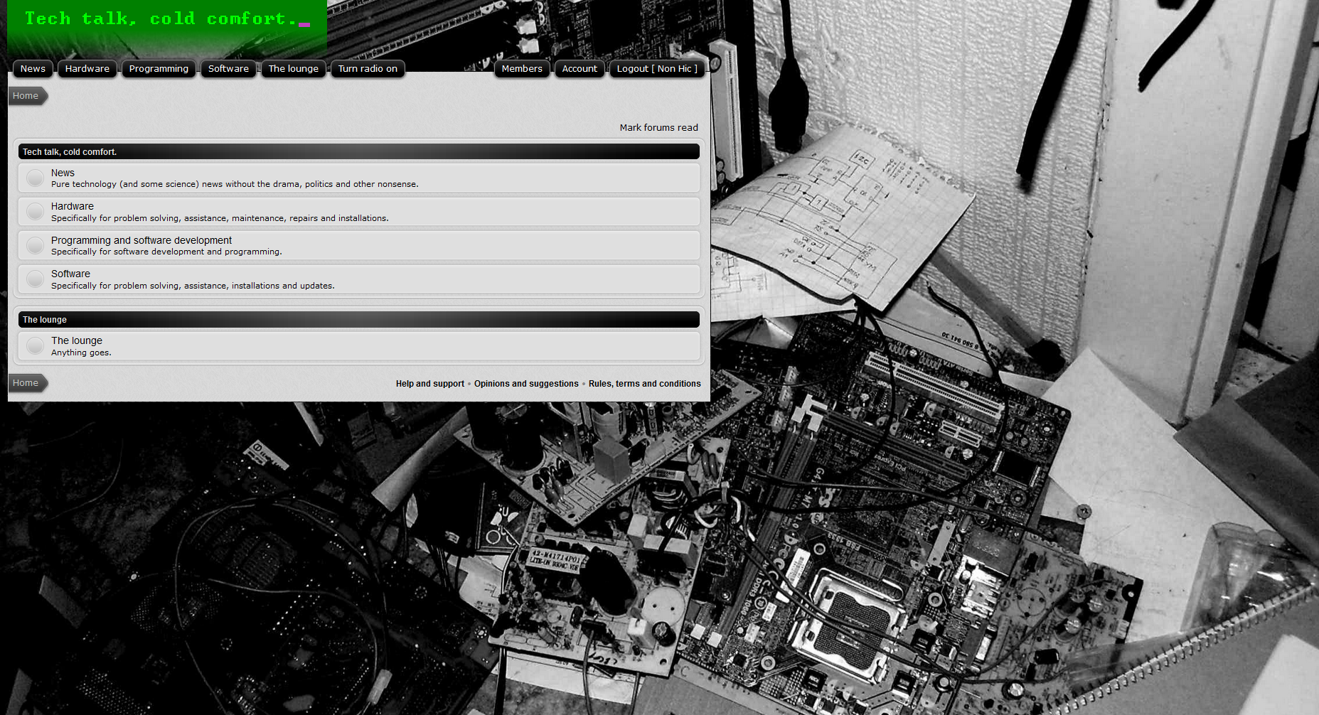

2014-05-23 01:52 »
With radio on:

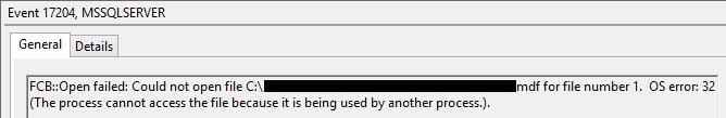

2014-05-23 14:31 »
Sorry, my bad! :oops: :oops: :oops:
MSSQL error open failed could not open mdf file.png (5.43 KiB) Viewed 18068 times

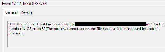

2014-05-26 10:39 »
Again with this error message. It wasn't my fault it seems but this puts our techtalk.cc database into "recovery mode" so in case you see some odd connection error, this is what has happened. :problem:
Worry not, I'm trying to fix it. The database is just fine, however. This has something to do with the server, I might have chosen to allocate too little CPU resources to the server. I'll keep an eye on this. :silent:
mssql error.png (9.38 KiB) Viewed 18029 times

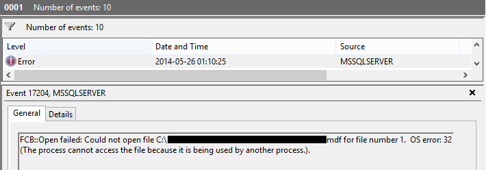

aaaaaaaaaaaaaaargh! Got the error again! "#¤@£$@£!"#¤!"#¤@$£ :evil:
"FCB::Open failed: Could not open file C:***.mdf for file number 1. OS error: 32(The process cannot access the file because it is being used by another process.)."

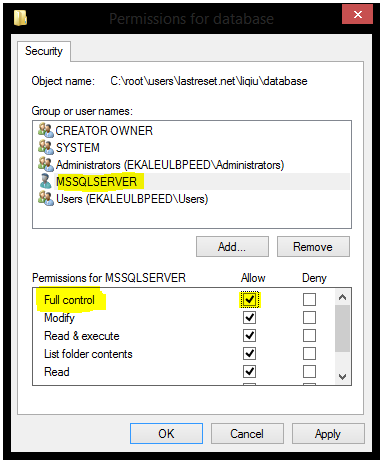

It seems that you get the error only sometimes because our database files (MDF/LDF) are not located in their default locations in the "C:Program FilesMicrosoft SQL ServerMSSQL11.MSSQLSERVERMSSQLDATA".
Probably some odd permission issue so I have now added the "NT ServiceMSSQLSERVER" (If you have a named instance: NT ServiceMSSQL$InstanceName) account to the files and folders of our MDF/LDF locations. (Full control)
Hopefully, it will solve this problem. :shifty:
