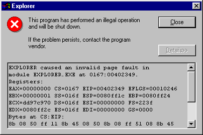

I'm getting this error every time Windows 98 boots:
Windows 98-2017-05-21-22-11-09.png (5.85 KiB) Viewed 10523 times

Did you have any other packs installed?
Mario
2017-05-23 00:45 »
No, I installed 98lite, then I installed the service pack.

@ Mario
Your issue might be from stripping too much out with 98lite.
