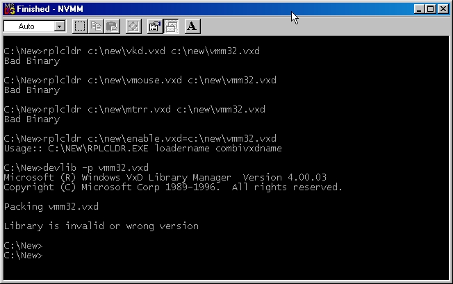

RFMaster, I had a couple of thoughts that don't seem to be working out. I thought I'd share with you and get your thoughts on mine.
I attempted to use a Hex editor to mod the VMM32.vxd extracted from a Win98 SE CD to match the VMM.vxd from the German patch (I left it named VMM32.vxd). I then modded my original vchache.vxd (from VMM32.vxd, my original from PC running 98 SE) to match the German version. There were very minor changes in each. I also extracted all the rest of the VXDs from my original VMM32.vxd
I attempted to use Wininit to rebuild the VMM32.vxd (in a separate folder not replacing the one in system folder), it failed with a generic error message saying it could not combine the VXDs. Do you think that the Hex Editor could possibly be damaging the files? Maybe something else going on?
I hope what I said is clear, if any confusion, please let me know.
Posts: 3176
2014-05-18 04:12 »
Something's not right. Wonder how Windows boots with my modded VMM32.vxd?
RFMaster
2014-05-18 04:35 »
Steven W wrote:Do you think that the Hex Editor could possibly be damaging the files?
Yes.
You can't just put some bytes there.
It's complicated.

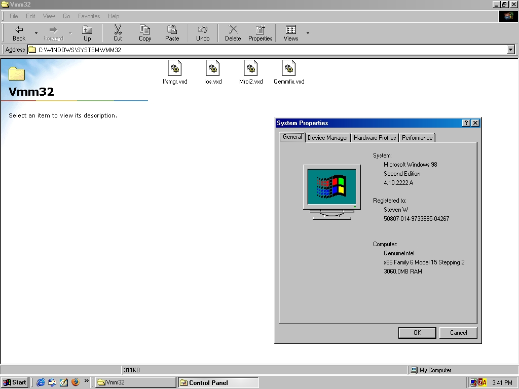

2014-05-18 21:45 »
Yeah, I've cracked the nut, with the help of RFMaster's patch and a hex editor:
Notice what's not in my my VMM32 folder. Give me a few to write out the details.

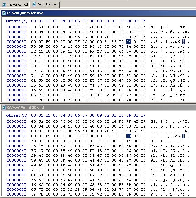

2014-05-18 22:14 »
Okay, as far as RFMaster's Patch here's a screenshot showing what needs changed:
VMM32O.vxd is unmodified from install, VMM32P.vxd is the patched version. Basically that 04 needs changed to an 00. RFMaster if you could rewrite that patch to not need the file name (just mod VMM32.vxd) change that would be great too, you'll see why when I explain the rest. I'll explain the rest in next post.
