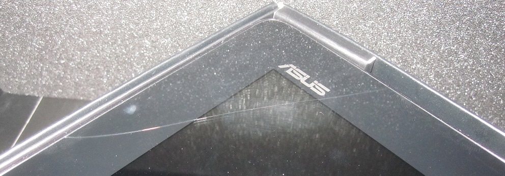

After slightly less than a month of very careful use (since it is my first tablet device), at some point when closing the tablet with its dock station (as a laptop) a thin hairline crack appeared instantly across the entire screen:

Attached is the picture of the crack and a map of loose glass on edges (these were found by tapping the finger across the devices edge. The map shows areas where clicking or very audible tapping sound is heard).

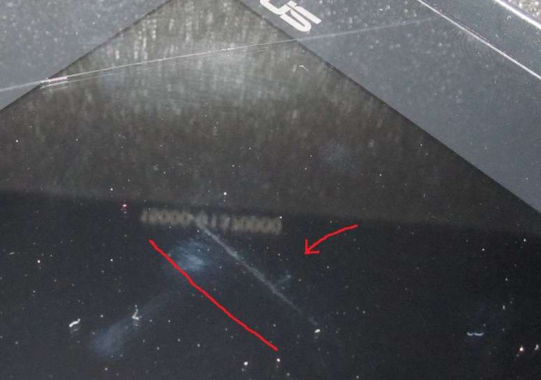

I see, well here's a picture of another defect on the previous (damaged) screen. I don't know if it has any connection, and it was a really hard defect to spot (somehow this only picture has it):
Same defects are appearing on my new screen as well. I do not have any idea of their origin, but they are relatively minor on the new screen, not a big line of damage line on the cracked one.
