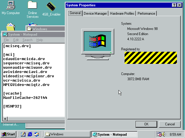

Jimmyjam
2014-06-08 15:08 »
Okay then, starting from a clean slate for another test is easy enough. I wasn't aware your patcher interacted with system.ini in such a way.
I tried again using the following procedure:
Brought the machine back down to 512MB of memory
Format
Install Windows98SE
Install Problemchylde's USP3
Reboot
Patch with 4G_Enabler
Reboot again, verify that the system works OK with 512MB memory
Shut down, swap memory to 3GB and restart
"VFAT Device Initialization Failed."
Same issue. Windows just can get the VFAT driver loaded.
I figured I needed some kind of control subject to make sure I'm not doing something wrong so I set up a test in a VM instead using the same procedure as above. The end result was that the patcher worked as expected and the system in the VM had no trouble booting and recognizing 3GB of memory.
So then I tried replicating the state my hardware was originally in using a VM:
Set RAM to 512MB
Install Win98SE
Install USP3 & reboot
Install Himemx & XMSDSK and set up a 2GB ramdisk in config.sys/autoexec.bat
Set MaxPhysPage=30000 and MaxFileCache=262144 in system.ini
Shut down, set memory to 3GB and restart
Verify that system boots and works properly. Ramdisk is mounted and system shows 768MB of memory
Rem out Himemx and XMSDSK lines in config.sys/autoexec.bat
Remove MaxPhysPage=3000 from system.ini but leave in MaxFileCache=262144
Patch with 4G_Enabler and reboot
Patch worked, system starts properly and shows 3GB of memory.
Start drinking heavily
I'm positive it's a lower memory range issue with my hardware at this point. I need to figure out some way to move any resources that don't absolutely need to be in the first 16MB of memory to someplace else in RAM. Something to research tonight or tomorrow, I guess.
