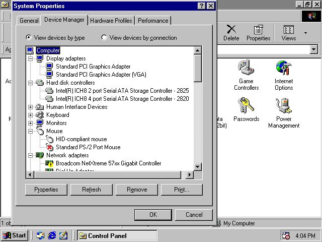

Here you go, "!":
I installed VBEMP 9x
http://www.bearwindows.boot-land.net/vbe9x.htm
Changed the wallpaper and was running a few programs. I've made several changes to the OS and rebooted several times. Preliminary guess is that UIDE is good with the /B switch and NOIDE in the registry.
