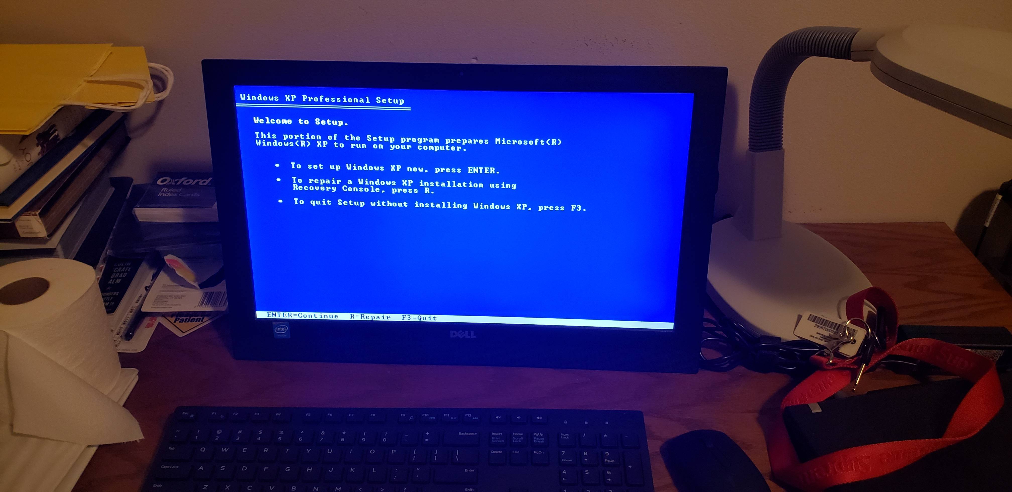

It works! Using the custom drivers, f7, rloew and Damnation's suggested cab file makers to successfully replacing the ACPI.sys file, updating the bios, and f7 made it work!!!

Aiko
2019-04-26 09:24 »
https://i.imgur.com/480GdEn.jpg
